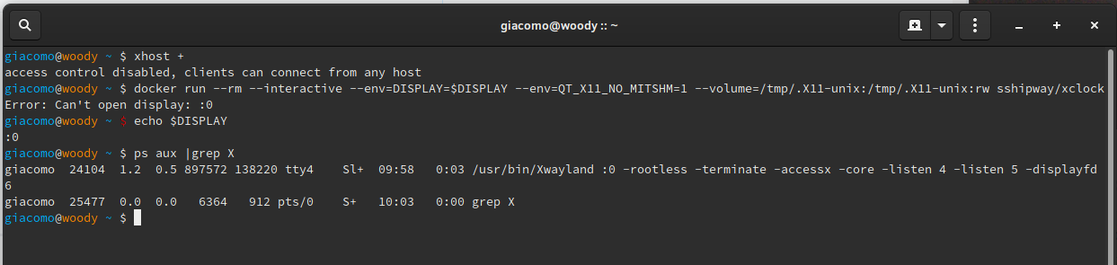

Thanks @puneetse, this does not work for me.
I must be missing something…
See the attached screenshot.
Let me know if you need more detailed information about my Clear Linux installation.

Dear @bdeandocker_Xorg
Unfortunately, the result is exactly the same.
