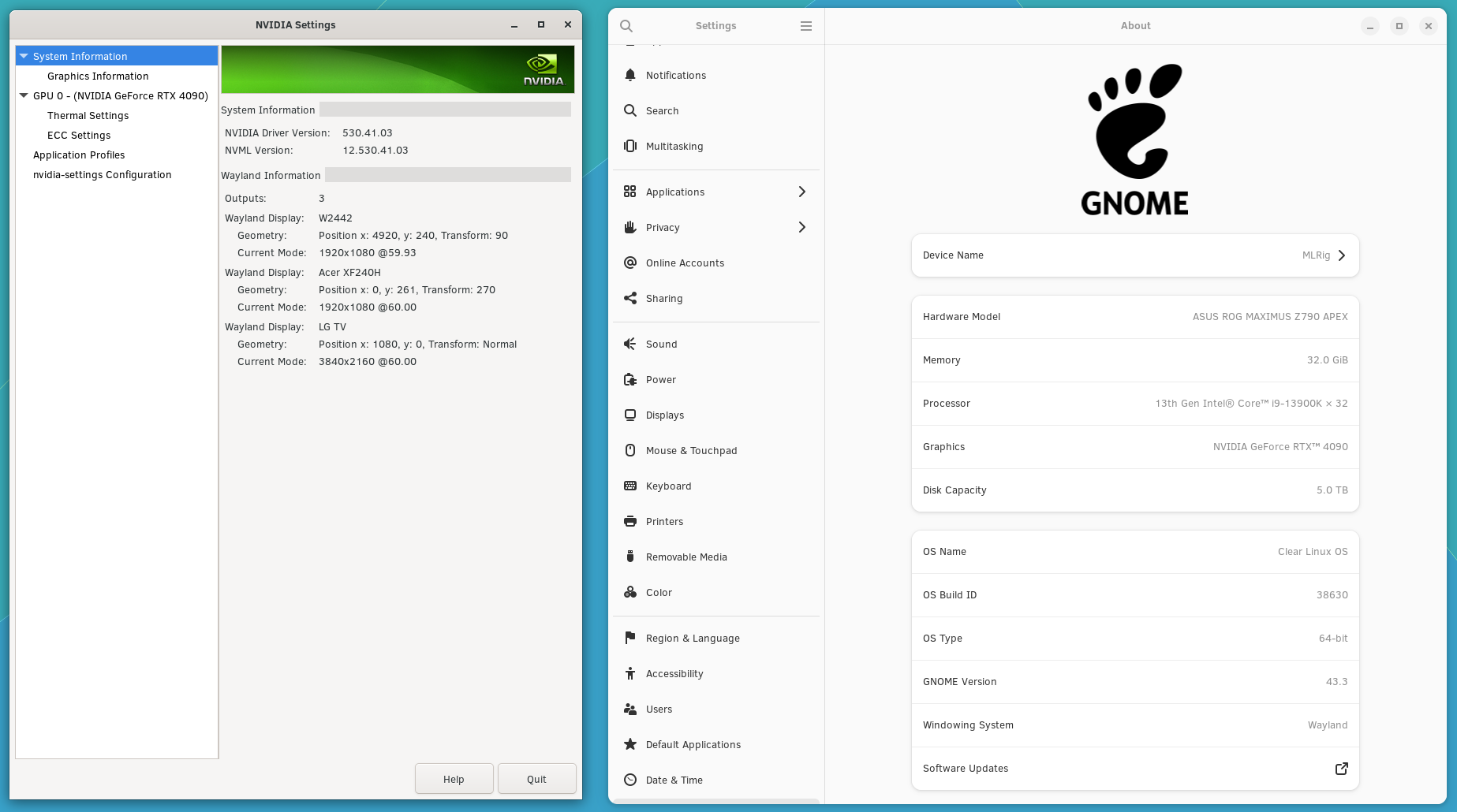

Update:
Installed it using your amazing and clever repo!!
./install-driver ~/Downloads/NVIDIA-Linux-x86_64-530.41.03.run
There were no errors during installation.
