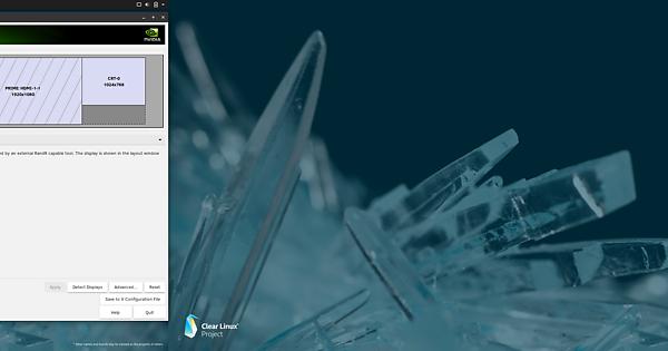

I got prime-sync, gdm login screen and all working here.
Before:
After:
Using monitos.xml
There is more to it then you can find at the clear linux forums, using prime sync I noticed the gdm login screen was empty, but in fact funny it was displayed on the crt-0 ghost screen wich you cannot see as some vga bioses have them hardcoded, I could just hit ā€œEnterā€ and enter the password and the desktop would load. The key is to right click on the desktop and setup the display settings, if all is ok you will have a monitor.xml file in .config, then you can copy this xml over to gdm, ā€œcp /home/username/.config/monitors.xml /var/lib/gdm/.config/ā€
And login screen will work again like we all are used to, I also suggest not to use the baremetal kernel, it will break the driver more often so I decided to stay on the latest LTS kernel.
I will upload my configs to my github soon, just need some time because some of the scripts are from others, so either I inform them or copy them and just metioning them.
Have a nice day!
