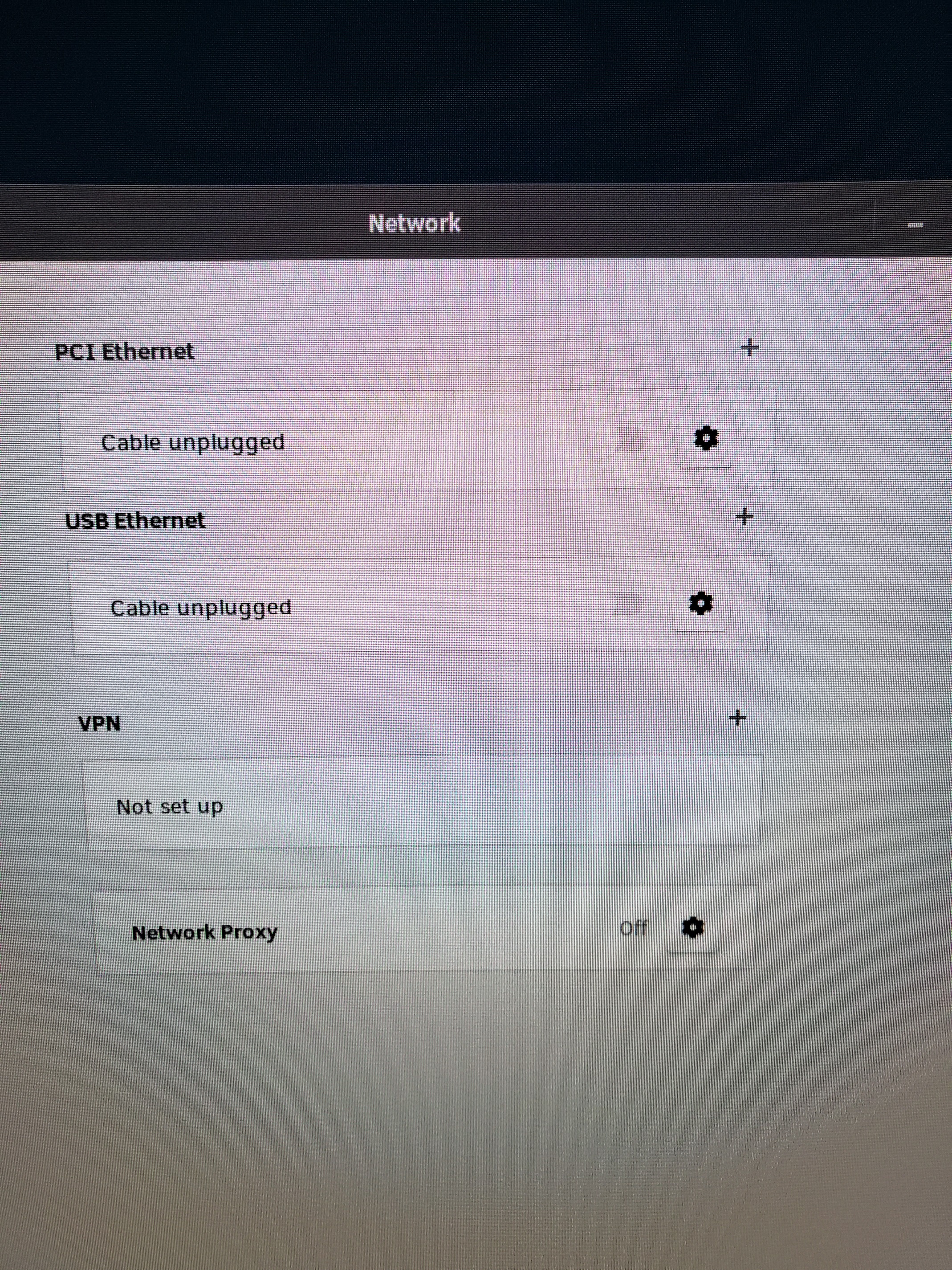

That’s the problem, I dont have an ethernet access at this time. And I cant get a USB tether from my phone to work either. Would that be easier to get working?
I’ve tethered from Android phones without issues. Both wifi and USB. Check your cables and replug. Try restarting NetworkManager and read this thread as well:

I am sorry but 43a0 doesn’t work with b43, I know because I have one. You must compile and install the hybrid broadcom drivers. Which means you will need to grab the kernel headers rpm from the clear linux repos so that you can compile on the live cd. You will also have to disable signature verification on the kernel by adding to the grub kernel line:
module.sig_unenforce
in order to disable it. I would also suggest using an ext4 formatted flash drive for this operation and compile it there so you are not taking up the ramdisk.

@Clyde_Barrow try this: GitHub - antoineco/broadcom-wl: Broadcom Linux hybrid wireless driver (64-bit) it has worked for me
i have the same wifi card and it’s working nicely now
