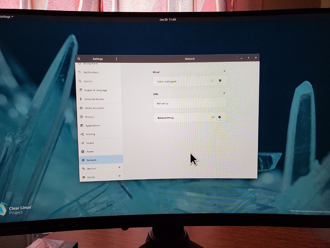

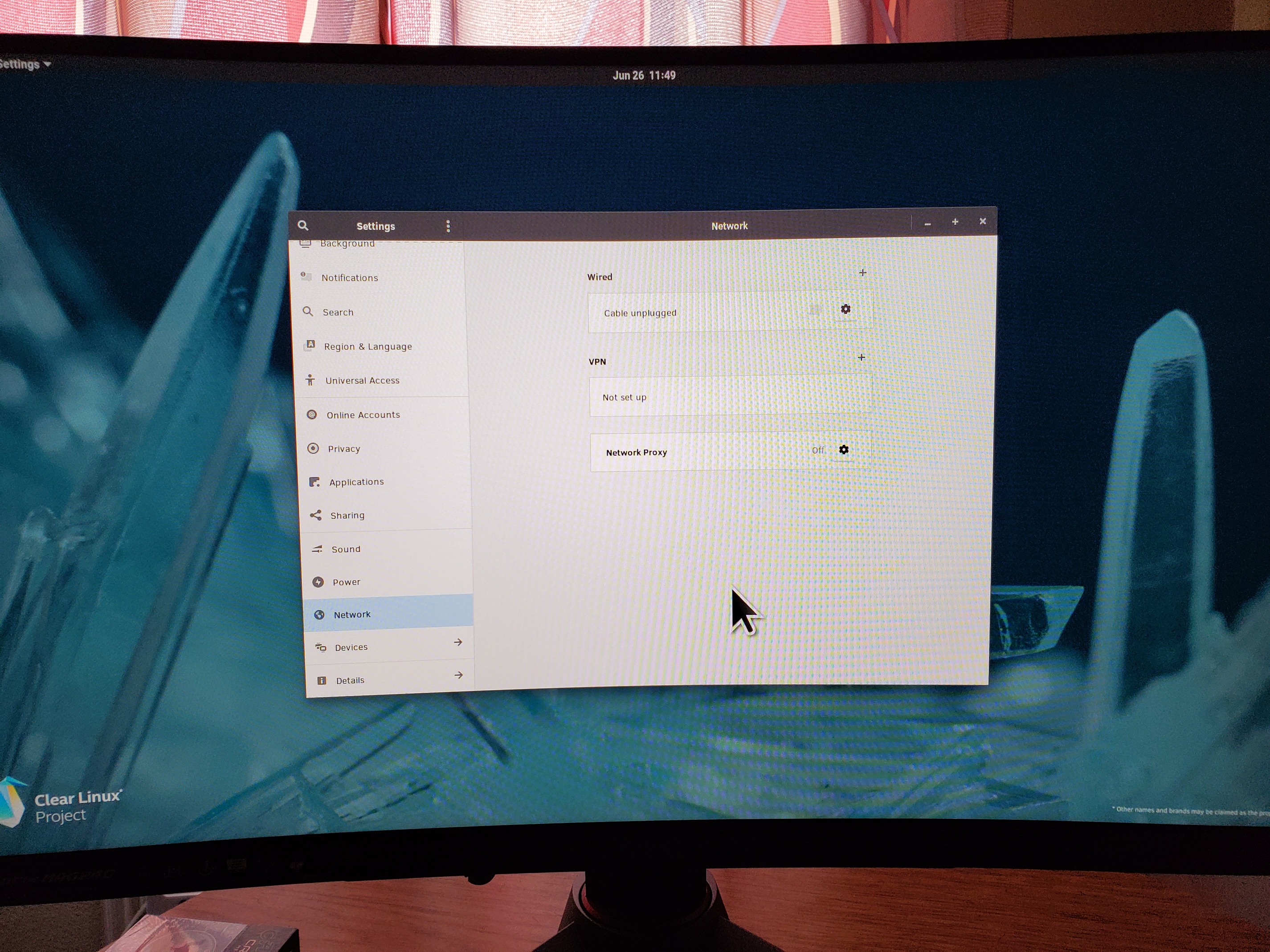

Now, there is no wireless connection shown after booting into Live USB desk top. ??? And of course it cant be installed unless there is a network connection.
I seen where wifi is in the settings sidebar…however it says there is no wifi adapter plugged in. But there is. It’s a TP Link PCI wifi adapter and it works fine in windows. I just currently have no ethernet access where I am. Is there a drive I can down load and install manually? Please help

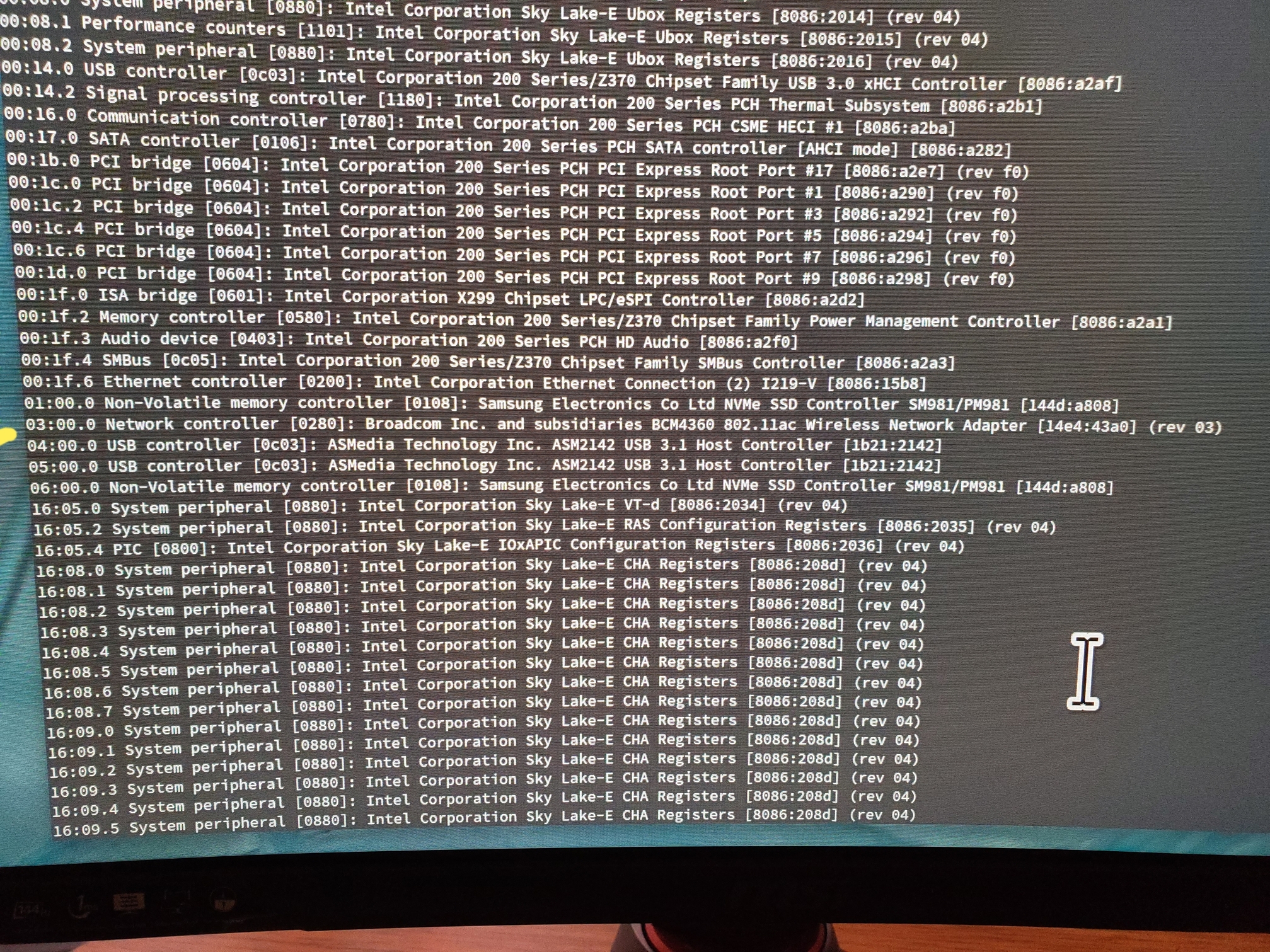

Please post lspci -nn - we need the device IDs as well, not just the name.
Ok. Working on it now. Gonna load the live 30090 USB in about 5 minutes

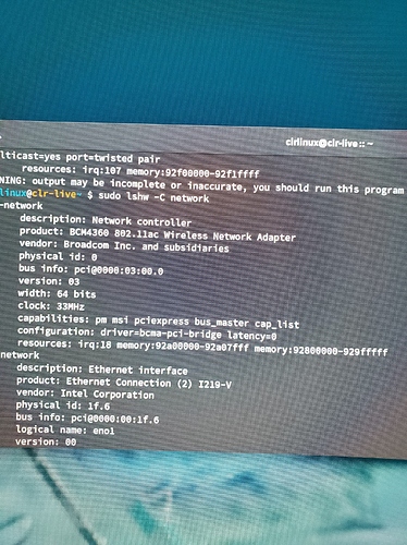

Ok. Here’s the output. I put a small yellow mark to indicate the network controller.

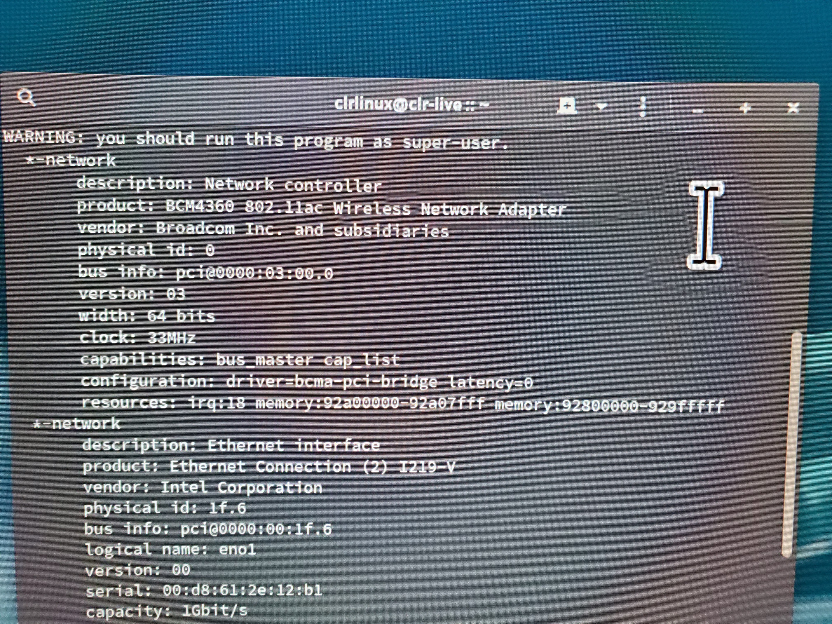

And here is another pic of the wireless network adapter
Now I ran the same command as root…there is a bit more info
Sadly BCM4360 [14e4:43a0] does not have an open source driver :frowning:

It needs proprietary firmware. do sudo dmesg | grep firmware and see if it complains about a missing formware file.
we have the module called b43. Firmware from userspace is required for device operation, and CL can not ship this firmware.
once you get the firmware file, you can place it at /etc/firmware and unload and load the module.
Note: you need to create the directory /etc/firmware.

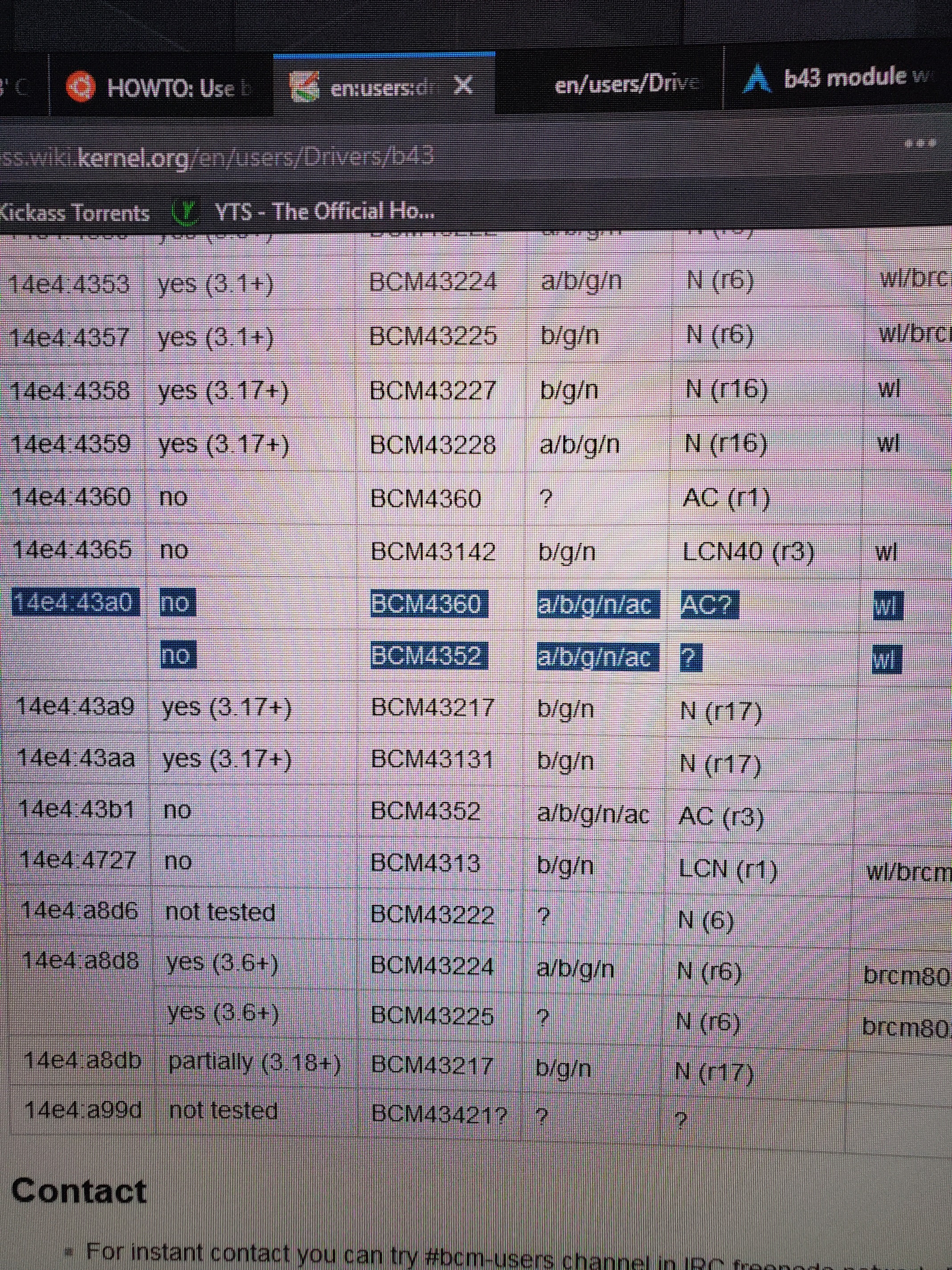

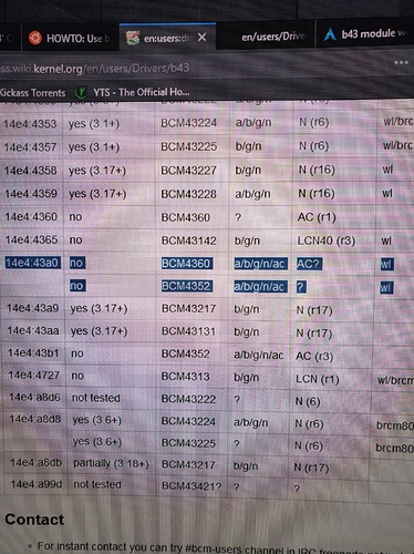

Hello again…just looked here and it says b43 will not work with my wifi adapter. I will post pic. Says to use wl driver instead. Can you double check that for me?
