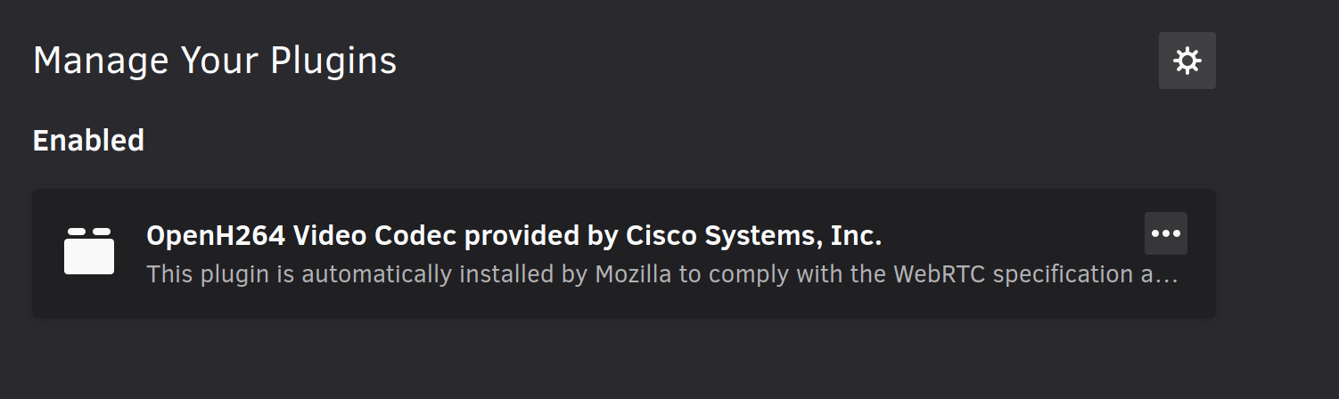

I just created a topic here as a guide to installing the Flash Player addon to Firefox.
