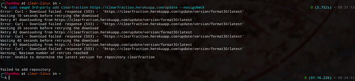

I can’t add the repo to swupd, the error :
curl -download failed: response (503) ‘https://clearfraction.herokuapp.com/update/version/format30/latest
Fixed✌️
500 hours per month isn’t enough now to keep the repository up, added more fuel.
