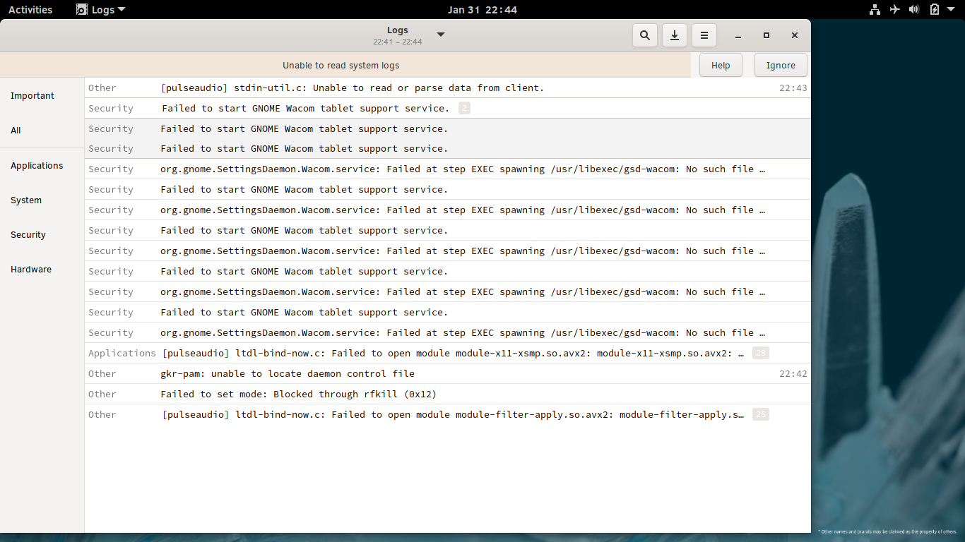

When I try to open hp-toolbox or hp-uiscan .
It doesn’t open .I can see no module named PyQt5 in logs .how do I fix this issue?
Did you try installing PyQt5 · PyPI?
yes but log shows same error
Can you provide the relevant log?
im not using cl .i will see if i can install it
Okay. But maybe stay with the distribution you are already satisfied with.
Anyway, with “log” I meant the output python gave you describing the error when trying to run the application you were trying to run.
i think installing it fixed it but hp-uiscan has no icon
Maybe it doesn’t includes an icon?
