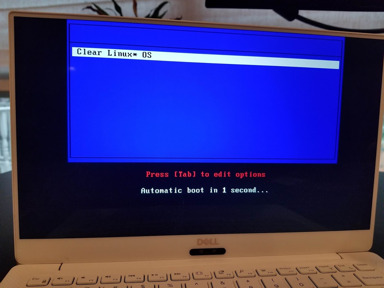

I’m having issues with the USB installer on a Dell XPS 13 9370. I get Wrong EFI loader signature error (see image below).
Details
This laptop originally came with Windows. I removed Windows and installed Ubuntu. I’m now trying to install Clear but I get error: Wrong EFI loader signature.

Is this the first boot from the USB image, or the second boot of the (newly) isntalled clearlinux?
Are you dual booting with Ubuntu? Is that the GRUB bootloader?
This is the first boot from the USB image (clearlinux has not been installed yet)
I want to overwrite Ubuntu. I get the error right after this screen:
I created the USB installer using Rufus (followed steps from clearlinux website). I also tried creating it with Etcher - same result.
UPDATE: I tried booting (using same USB installer) and got the following error:
I’m leaning towards the USB installer being corrupt… I’ve tried downloading and writting the USB many times with the same result though. Any suggestions?
