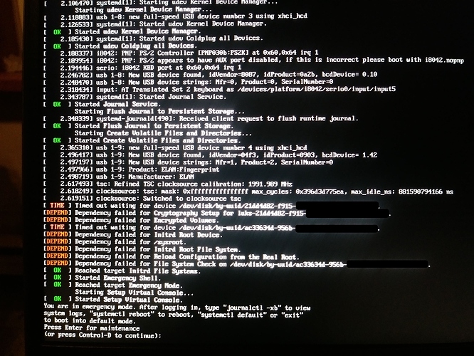

I just did a sudo swupd update to get the latest version of the OS - 32610. I believe I was on 32580 prior to that. Just rebooted and now the machine just sits at a flashing cursor in the upper left hand corner of the screen. I am unable to type any text.
I have a luks encrypted partition for CL that includes my home directory as well. Running on an ASUS zenbook UX430U with integrated Intel graphics, no other graphics card.
Normally my machine boots straight to the CL partition and immediately asks me for the LUKS password at a prompt before proceeding.
Windows 10 is installed on a separate partition that I boot to using the bios boot menu only no grub or any other boot managers. Windows boots fine still.

I just used a live usb of Clear Linux. On booting I was able to open Gnome Disks and unlock my LUKS partition with my password and mount it. All of my files are present. I was also able to mount the EFI partition and edit loader.conf. I added timeout 10 to show the boot menu.
I then tried booting both kernel entries with the same result as before.
I then tried pressing ‘e’ on one of the entries and edited the options line, deleting all options except for the uuids to mount. The boot process proceeds and waits for 90s to mount the uuids listed. This fails after that time period. I took a photo of the screen with my phone and have attached it.
Any help would be appreciated.

I think the kernel in 32580 was the same as the older kernel option I tried from the boot menu in this release 32610) unsuccessfully. The kernel in 32580 was fine.
