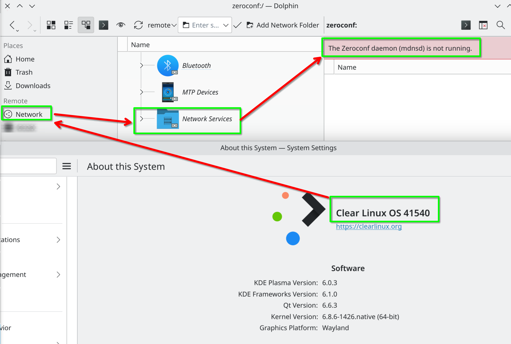

After starting Dolphin there is now a new error message:
The Zeroconf daemon (mdnsd) is not running.

In the newest version it changes back to the original error message:
Still broken in the newest Update:
